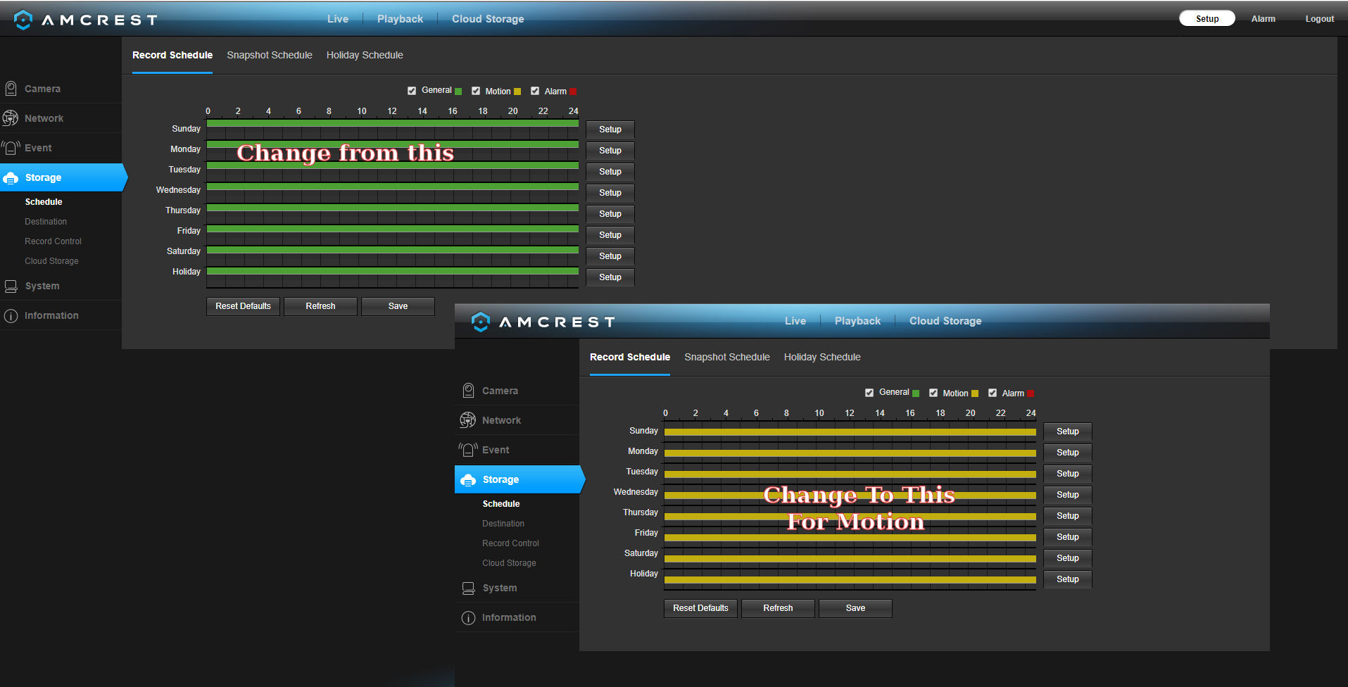

So that was what I was trying to explain... ACF might have something to do with the Recording 24/7 if it isn't in your setup under normal area of such...
So I am going to guess that the difference is that this Outdoor Camera came with the 24/7 already active in setup by design... While I have 3 working 4 total 841 I can't remember with all the settings and setups and changes just how they came setup... So I will take the Last of of the 3 that is close to me and Reset it back to Factory so I have first hand account lol...
My logic behind this is that the Outdoor camera is more of a Security Camera in design and the others while they do work as a Security Camera has been in my thoughts more of a Toy lol...
So in my last post there was also mention about changing the 24/7 from the Schedule area of the Camera... I am going to guess that it is setup to record 24/7 by design seeing it is outside Camera...
See Picture
See Picture
Re: Amcrest IP8M-2496EW - Recording Question
WOW ok... So just did a Factory reset and sure enough that is how it comes up Motion and Alarm only setup...
Well now I have to go back and configure my camera so I just wanted to update what the 841 did on setup... As I can't remember much these days My mind isn't as sharp as it was 30 or 40 years ago lol...

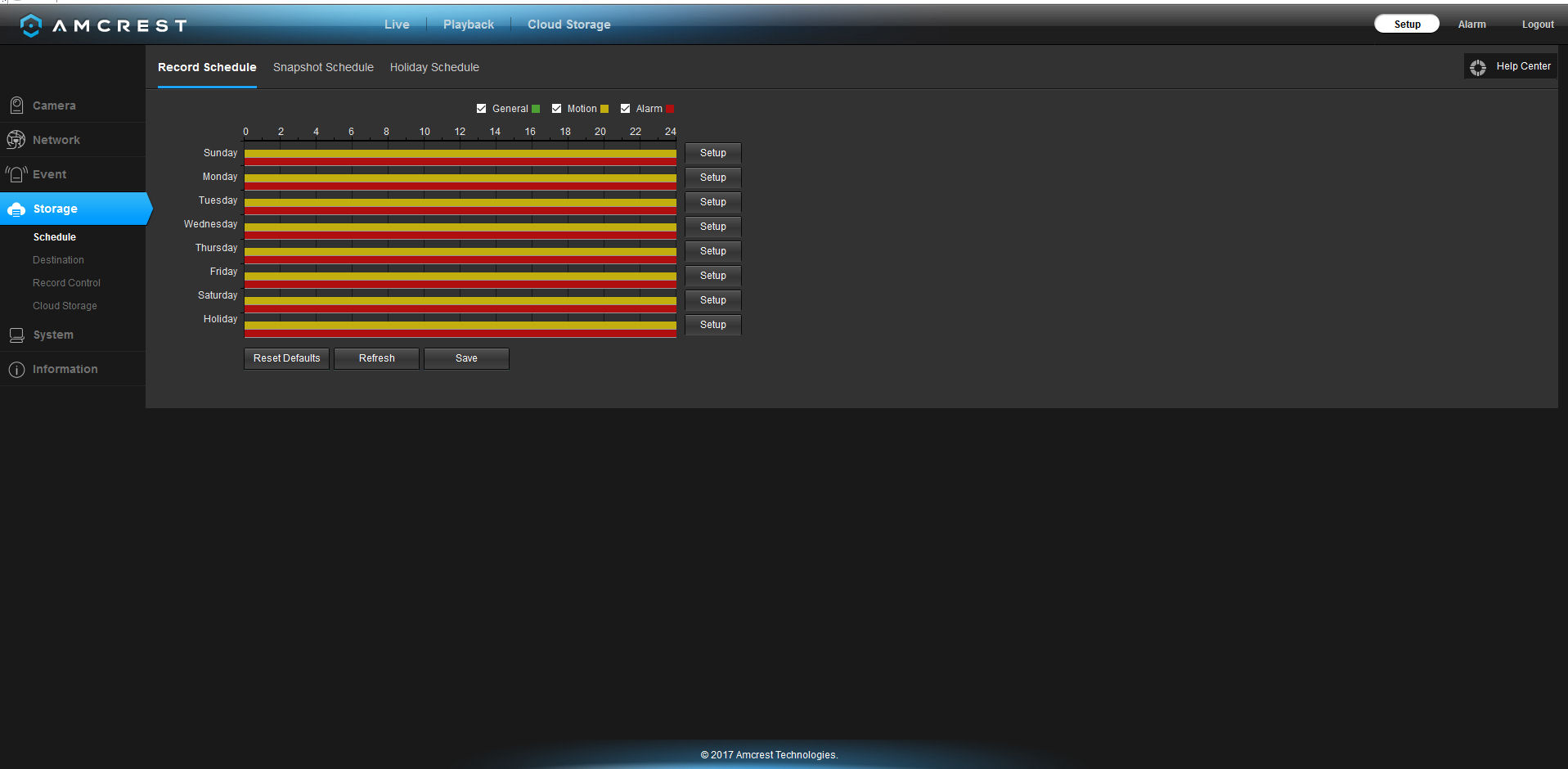

My screen shows Yellow and Red across from 0 -> 24 every day. Again, as I said, I didn't touch these settings other than those two I listed in my post. So the yellow & red must be the default of my camera. I never touch this screen on my other 841's either.
i posted my last reply maybe at the same time you posted your last screen. Yes, that's what mine looks like. Sorry you had to re-configure your 841. You could have done an Export first. lol
