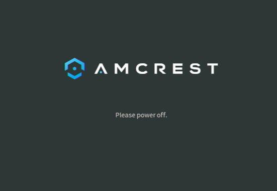

Second, The NVR is plagued with the issue of being able to turn off the device from Remote connection or local connection over the WebUI. This is a Flaw that I mentioned on the HS model and others. Why this is an issue is, If you are not local to the unit and you do a shut down. You can still log into the device and it will display all the cameras and give the idea that the device is active. However lets say while you were online the WebUi being remote and you see an event happen on a camera you know is setup for that event. Then you try to play it back doing a search for the event will come up empty. So then lets say that you think maybe the HDD is full and you have it setup to Stop Recording when full. Looking there your HDD is only 1/2 full so you don't know what is going on. However if you look at the screen on the NVR's GUI you will notice that it says
