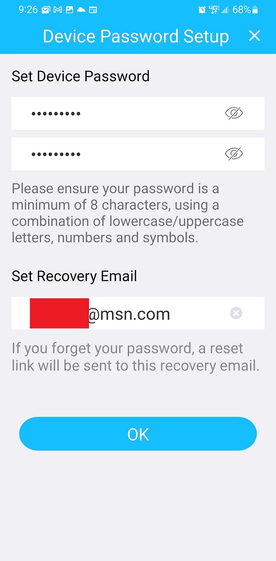

Connect to your Home 2.4 wireless connection, Then go to the camera, Remove the front plate, Bring up on your phone the Smart Home App, Then click the + to add the camera, It will ask you to scan the QR code on the camera, Then after 10 to 20 seconds after you get to the part of turning on the Hot Spot it should pop up and ask if you want to connect to it. AD110 should be a DB type of hotspot. If it don't offer then open your cell phone wireless area and see if it opens under there. Maybe the connection is to far from wireless?
I just reset one of my Ad110, After you + and scan the camera it will ask if you have turned on Hotspot, Should pop up the next 2 screens before you setup what SSID you want to set it to. Then put in the password for the router.
SmartSelect_20220324-212649_Amcrest Smart Home.jpg (96.51 KiB) Viewed 2946 times
