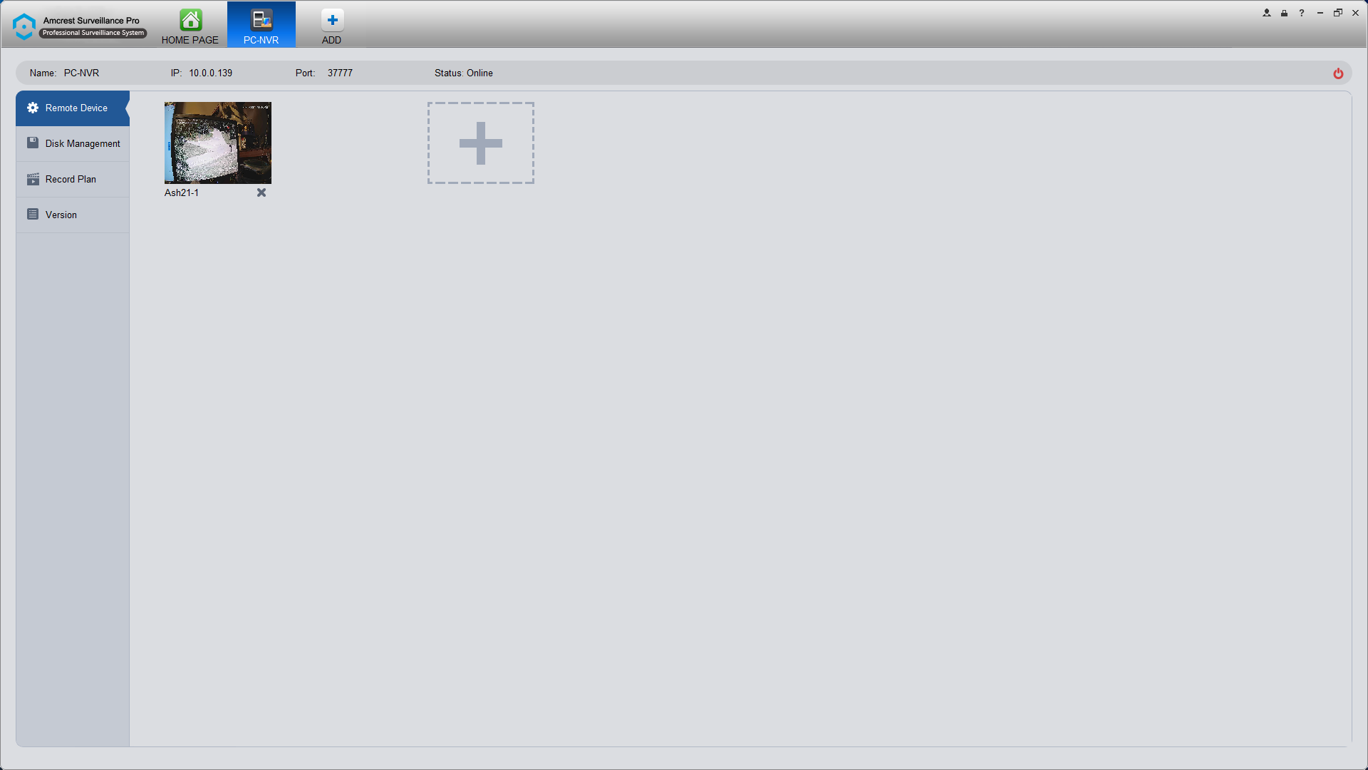

Posts: 6766
Re: Cameras will not save video / pictures to computer (PC-NVR)
@danzetus Hello and welcome to the forum
First question is have you setup your PC-NVR on the computer?
Second " How many IP do you have setup in that computer? If more then 1 PC-NVR won't let you set it up
Please load PC-NVR in side of ASP and take a Screen shot of the first page.. IP address don't matter but if there is any SN present please blur them out.. .
This computer don't have PC-NVR because I have to many IP's that is the first Picture I will show.. Please note in the first picture there is no IP and PC-NVR is not in the page.. On Second picture there is that Computers IP of 10.0.0.139 that is Host to my PC-NVR and another FTP server for my Cameras..
Screenshot (2514).png (37.83 KiB) Viewed 2743 times
This is a Picture of another one of my computers with PC-NVR setup for my Ash21
Screenshot (193).png (80 KiB) Viewed 2743 times
