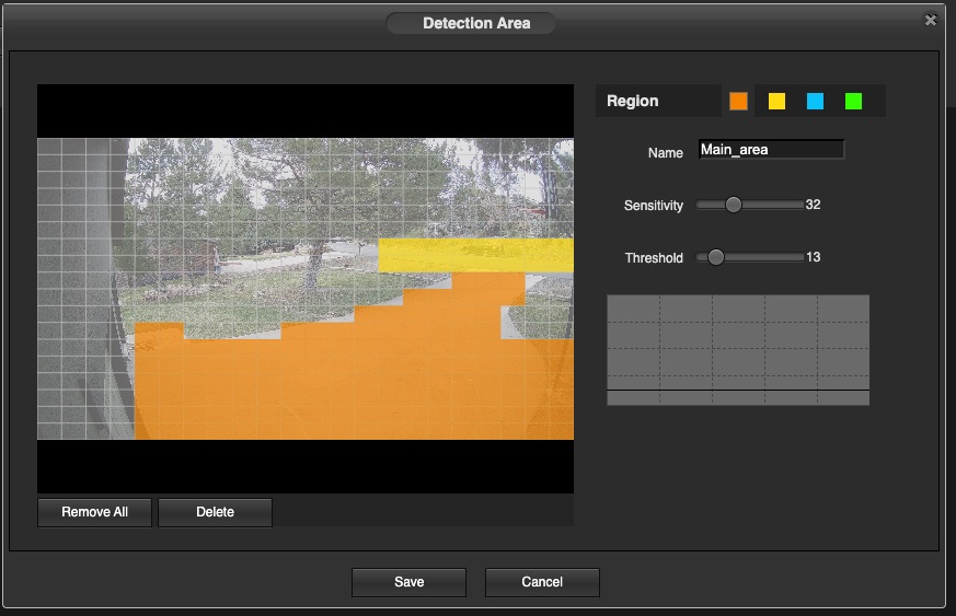

I have an IP8MT2599
The blocks I set up in the IP setup for "Detection Area" don't transfer over to the config view of amcrestcloud.com.
However, the sensitivity and threshold values do pass from IP setup to amcrestcloud.com.
Also, can anyone explain suitable values for sensitivity and threshold? Or point me to some documentation.
Amcrestcloud.com does not offer the same click-to-enable the grid blocks to customize the region--it seems to be "all on" (like the orange overlay below) or "all off".
Also, how does IVS setup jive with both of these region settings? I'd rather use IVS but that doesn't seem to work at all. Also seeking documentation on suitable values for "Target Filter" (Max/Min?) and "Pixel Counter". I set up an intrusion rule that doesn't seem to activate.
Motion area: which one wins? Amcrest Cloud or IP setup?

Don't want to tell you how to setup your camera but the way it is setup right now you might have some issues with false alarms.. IN your cameras FOV it looks like it needs to move little to the Right of the area in View to open your FOV... Any lights hitting the wall there will be detected as movement even when it is not part of your Grid caused by the Reflection within the real grid.

@Revo2Maxx when you say "... I do change the MIN Size to fit my needs..." what do you mean? What are your needs? My needs are likely similar to yours or any other user, right?
