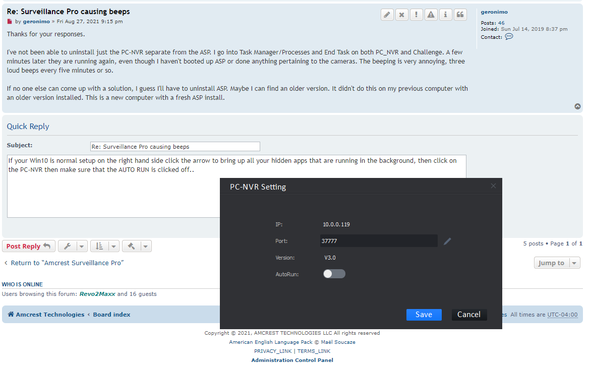

Posts: 6766
Re: Surveillance Pro causing beeps
If your Win10 is normal setup on the right hand side click the arrow to bring up all your hidden apps that are running in the background, then click on the PC-NVR then make sure that the AUTO RUN is clicked off.. If it is on click to Off and Save.. If that isn't an option might have to uninstall ASP and install again.. Then just make sure that it isn't setup for auto run...

geronimo
Posts: 50
Joined: Sun Jul 14, 2019 6:37 pm
Post by geronimo »
What arrow from what screen in windows for hidden apps? I don't know how you got to that PC-NVR Setting screen.
On edit. Okay, I found that screen. It is not set to autorun. PC-NVR does boot up every time I run ASP. Is there some way I can prevent that? I have no use for PC-NVR, but do enjoy using ASP.
