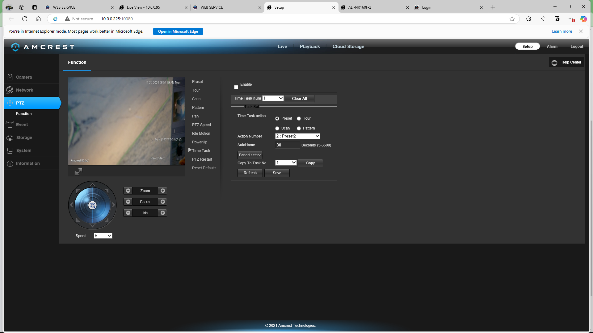

So I am working on one of my PTZ getting it ready for the next couple of years of life. So I am changing out Gel Packs and because of some health issues this year I am running far behind my normal schedule lol. But I thought I would put it up and show in one of my Amcrest PTZ what I am talking about. I these pictures on the PTZ page of the camera. This is connected to one of my POE NVRs so the IP address is for my NVR and the port is how one can access POE connected cameras. Just explaining why the IP looks funny if someone seen.. Anyway had to access over the NVRs Virtual Host. So anyway here are a few ways that a PTZ camera can get things all messed up. Keep in mind that if your camera is really at fault. Looking over the list of things here, If your system isn't enabled or setup for them keep an eye on the camera over the next hour or so. If the camera don't move on its own within that hour. Remove the power to the camera and then add it back.. I mean I have my cameras do a Reboot every night so if you do as well it might be that the issue is after a reboot so if you reboot camera by taking power and giving it back it could go back where it hides..
There are many other reasons but here are a few to try to work through for now. Doing a Reset of the Camera back to Factory Default, You don't have to climb the ladder always to do them some cameras do have factory reset in the WebUI.. Also on my camera if you look between the picture and the function you can see all the different things in the PTZ function area of this camera. Each of them could be the problem area for your camera if you happen to have them features in your camera..
Screenshot (3712).png (310.06 KiB) Viewed 13263 times
Screenshot (3713).png (316.6 KiB) Viewed 13263 times

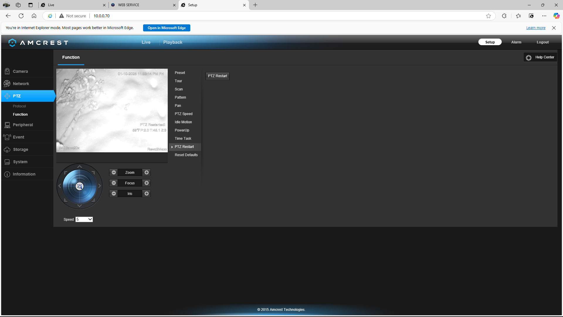

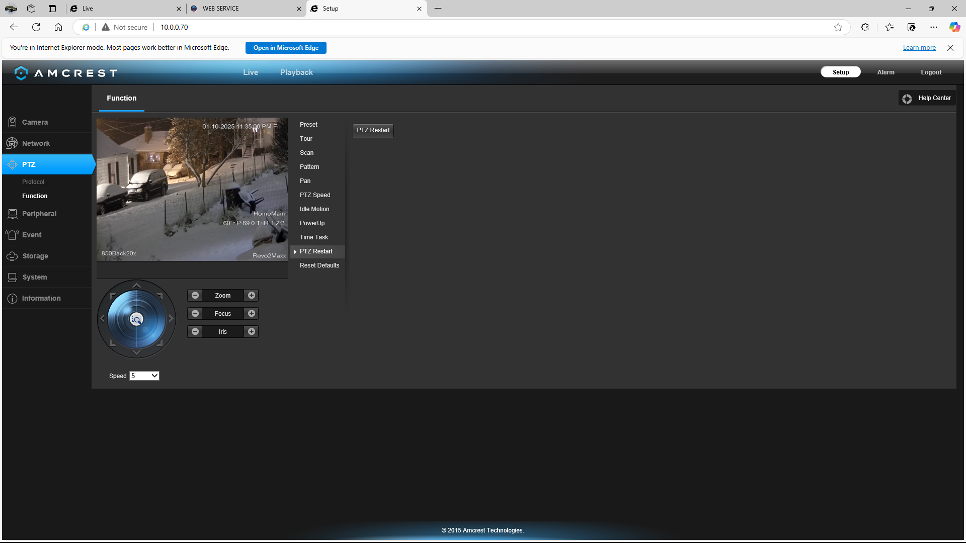

So to give you an idea of what I mean. Here is my 850EB from years gone lol. Anyway have a couple of these and a few other PTZ in many different areas.. But in the first picture after a PTZ Restart with all the Power UP and Idle turn off this where it loads.. Second picture with Idle and Start up turned back on. I mean just as easy as enabling the feature again.. After the Start up it auto goes to home preset 1..
Screenshot (4012).png (352.89 KiB) Viewed 10857 times
