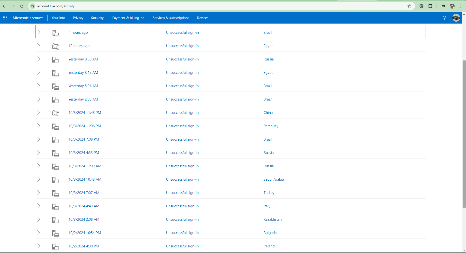

You know what, after looking at my account and all the failed attempts of trying to hack my account, I am not going to be using my MSN or any outlook accounts that I have to access my machines. I am not sure why there are so many attempts on my account but I don't want to add anything that someone might be able to get access to my accounts.
Seeing I control my servers that I use to send and receive emails if something does happen to get past I will just restore a backup to my server and change my passwords. I have had my accounts for many years and don't need someone taking control. Already happened once like 15 years ago and took long enough to get that one back.
Screenshot (2812).png (81.81 KiB) Viewed 4657 times
