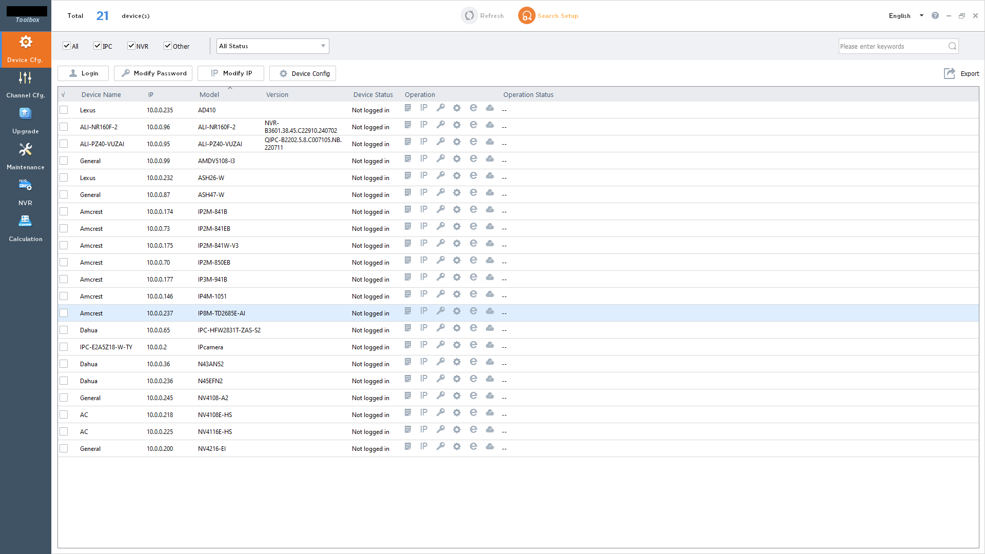

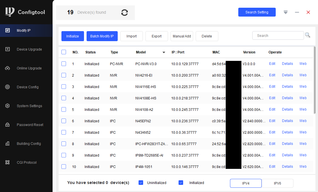

Sorry I keep forgetting that I don't use the standard Amcrest Ip tools, I have the one from Dahua and use a couple others that I can make changes that are not offered with the Amcrest tool.. Only one is branded with a name that is different and the Dahua tool desktop link looks like the Amcrest one so I keep forgetting that I don't use that one.. This is 2 of the main ones I use, Also have some Hikvision ones that are not on here and other machines that are in different segment of my network.
